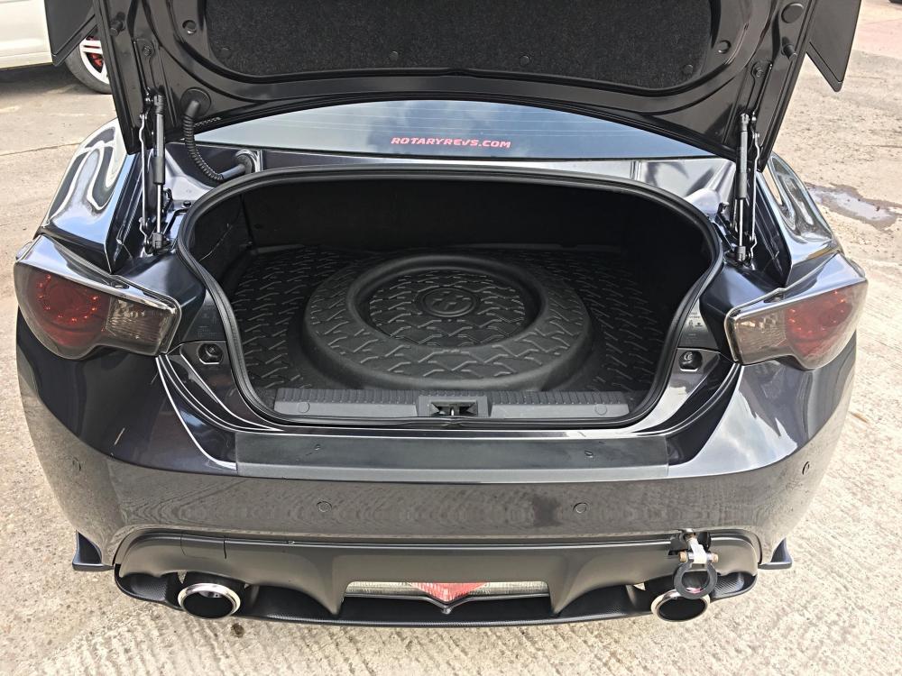

Church 209 Report post Posted April 16, 2018 AUDM twins had full size spare (probably because on australian desert roads puncture may happen also several hundeds miles from nearest tire shop). But to fit it also different boot liner is needed, as there needs to be bulb in center for full size spare to fit. Full size spare also weights more of course. Imho space saver donut, that will let one drive in case of emergency and which is something that can be more relied upon then tire repair kit (after usage of which most tire shops refuse to deal with such repaired tires, and often it results in having to buy pair of new tires (for same wear)) and won't rub already small boot volume is best compromise. Share this post Link to post Share on other sites
Test Drives Unlimited 278 Report post Posted April 17, 2018 I have a Full Spare Wheel in the Boot and 110% recommend carrying one as twice this year have had 2 flat tyres !! I bought the Boot Liner from Australia and cost a fair wack once taking Customs into account ! Share this post Link to post Share on other sites

Test Drives Unlimited 278 Report post Posted April 18, 2018 I really don't care what you think Lauren as I will always carry a full size spare wheel in my car !!!! Sent from my ASUS_A001 using Tapatalk 1 Mike reacted to this Share this post Link to post Share on other sites

Test Drives Unlimited 278 Report post Posted April 18, 2018 By the way just to add also under the Floor is a Subwoofer and Amplifier Sent from my ASUS_A001 using Tapatalk Share this post Link to post Share on other sites
