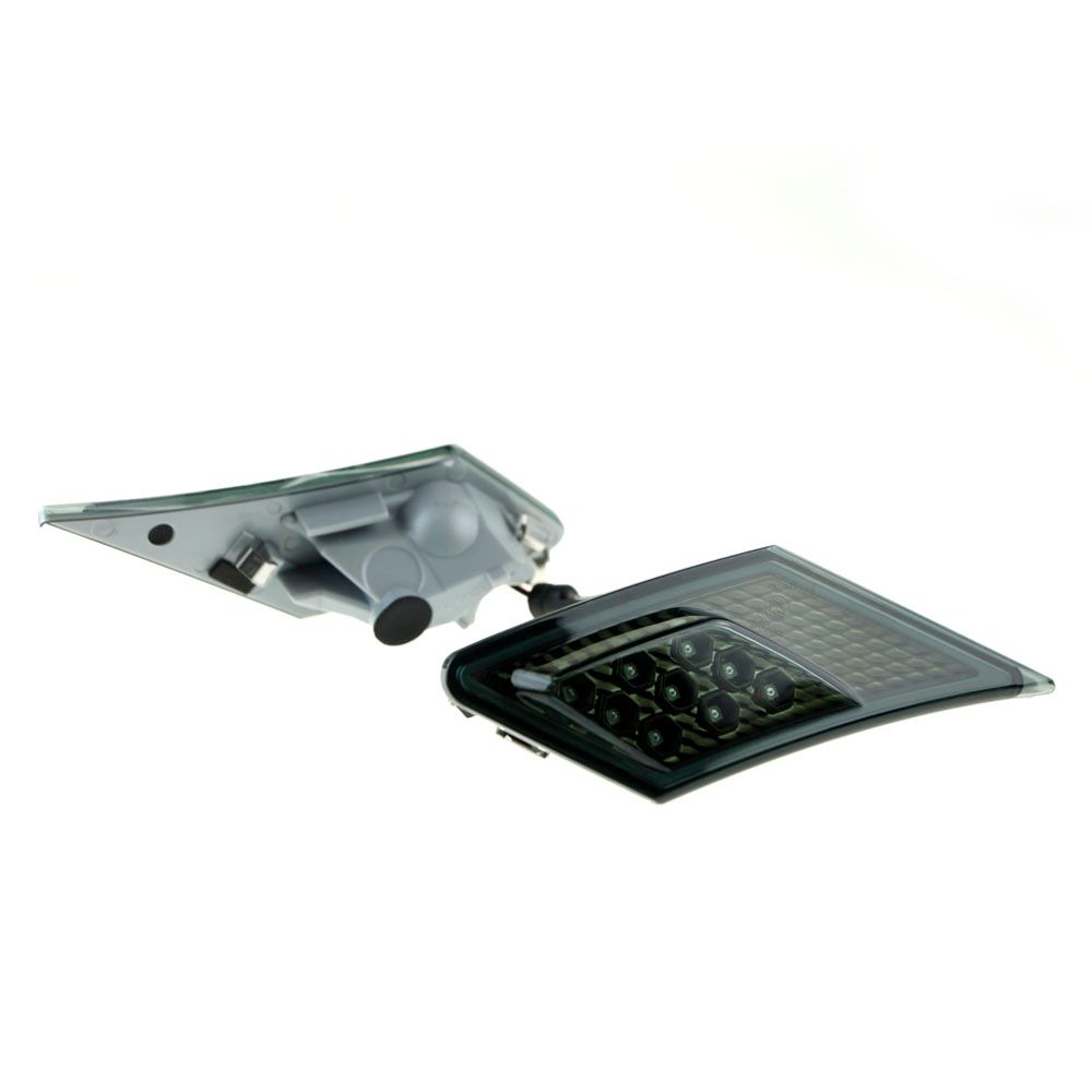

I've had issues fitting both Faith's and mine as the main bent metal clip
Image result for valenti side marker rear
(one on the far left) seem to stick out too much and won't fit in without having to bend it back before hand with some pliers, but then you run the risk of over bending it which means it won't stay in and continually fall out.  Mine don't sit flush but they do stay in.....unless you're car takes an impact which caused mine to come loose and eventually fall out while I was going round track.

As Keethos said, what's happening is that the clip is not holding it. Even though it clicks in, you need to ensure that it won't just pull out easily. I spent 5 mins looking at the bracket and then adjusting the clip so that it would hold. It makes it quite hard to actually push into place when done correctly. Mine now needs a screwdriver to remove like the OEM one does.
I had 2 get a second set as I wrecked mine with glue remover after eventually getting them fitted properly by Toyota lol (spent a combined 3 hours trying myself and with others with no joy). I fitted the second set myself within a few minutes including adjustments and have had no problems with them (no one else including Toyota could fit the second set). The problem I found is that the tab in question sticks out too far and you will see this if you compare it to OEM. I used pliers to pull them out a little and then squeeze them to bring them in a bit making them look the same as OEM, they then clip in properly with a loud click and only come out if I want them too. I'm pretty sure if you bend them out they'll be worse, I don't know how anyone can get them in after bending them out haha :lol: This makes it worse IMO. There is a video guide online somewhere backing up the exercise of pulling them out of where they sit a bit but I don't think it mentions squeezing them against the plastic holding them, this was required for me.
