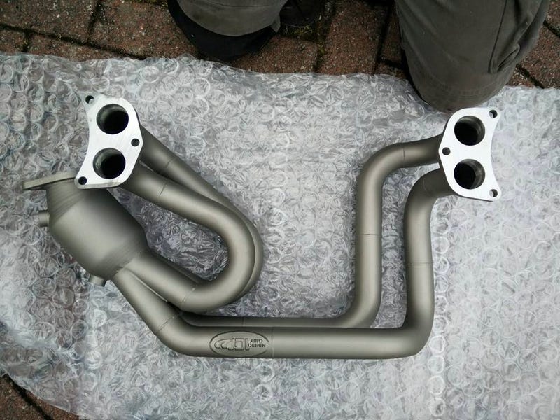

Church 209 Report post Posted May 4, 2017 rob: i'm curious, of what make is yours? Looks unfamiliar. Share this post Link to post Share on other sites
Kodename47 446 Report post Posted May 4, 2017 Just now, Church said: rob: i'm curious, of what make is yours? Looks unfamiliar. CGR Exhausts' Share this post Link to post Share on other sites
rob275 1817 Report post Posted May 4, 2017 As @knightryder said, it's a custom CGR system. Share this post Link to post Share on other sites
